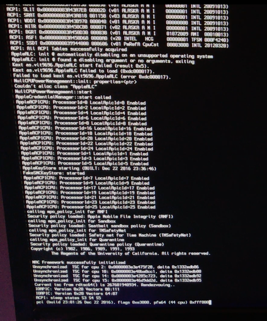

    Thanks DaTec! I attached it below. I also uploaded a screenshot of the error(s) I run into. It looks like I'm having a "Couldnt' alloc class "AppleALC" error, an "Unsynchronized TSC for CPU " error, and " RTC: Only Single RAM bank (128 bytes) " error which causes it to reboot
    I am using @Brumbaer patch ported to macOS Sierra and I also edited my VoodooTSCSync.kext's IOCPUNumber to 19 (to match the 6950x).
    Bios settings: AMI Version 1.3 (latest), XHCI Hand-off [Enabled], EHCI Hand-off [Enabled], Legacy USB Support [Enabled], XMP [OFF], MSI Fast Boot [Disabled], Fast Boot [Disabled], Intel VT-D Tech [Disabled], CFG Lock [Disabled]
    Let me know what you think or if you need me to post anything else. Thank you so much again!!!

    I just tried using an HDMI port instead but ran into the same issue except this time it only said " RTC: Only Single RAM bank " instead of " RTC: Only Single RAM bank (128 bytes) "
    Let me know if there is anything else I should try! Thanks again for any and all help!!:)
  • You have 1 x 16GB RAM?
    try Booflags:
    -f -v maxmem=4096 nv_disable=1 cpus=1
    Yes! 1 x 16 GB Ram stick.
    I ran the bootflags you suggested and got something totally different. I'm actually not sure what this error is. I've attached the screenshot below. Let me know what you think! As always, thanks a ton in advance for all the help!:)
