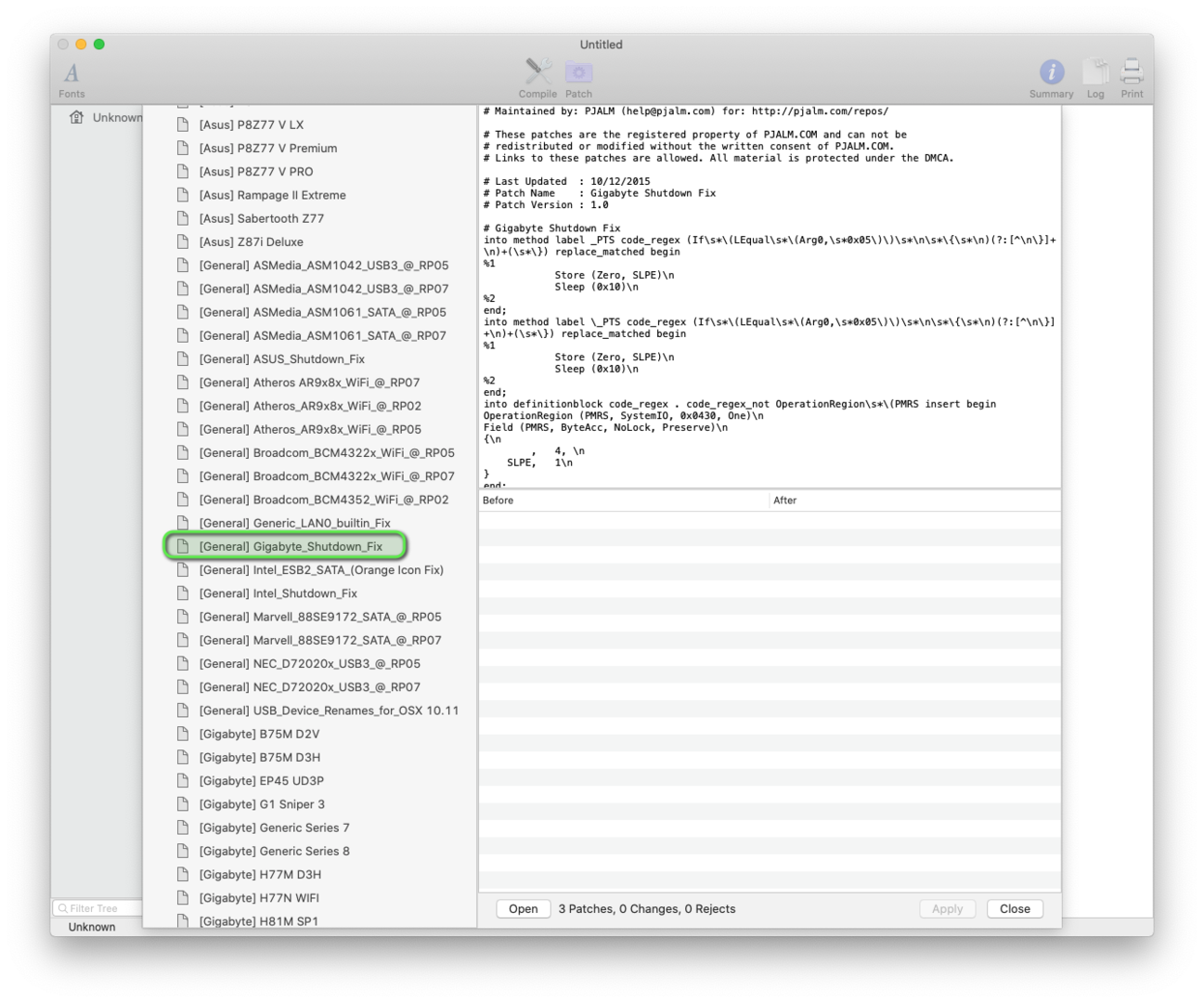

  • Since the thread is almost four years old, therefore comes from a time where DSDTs were more in focus, the here mentioned package was a good and helpful addition.
    Now most of the necessary DSDT-Patches are automatically insert via kexts and/or the modern bootloaders.
    Others were just use for "cosmetic" reasons, e.g having the list of internal PCI-Devices in the "PCI"-section of System Report, like shown in the following pic:

  • Does it also restart on a shutdown if you did boot without the DSDT?
    Otherwise I guess you'll have to check if the DSDT-Patch "Gigabyte Shutdown Fix" from 2015 is also available as a single SSDT-variant which you could utilise in OpenCore.
    Nick 725 gefällt das.
  • Right. It reboots with and without the patch. Can you tell us more about this "Gigabyte Shutdown Fix"? I don't have it.
  • This MacIASL-DSDT-Patch is currently only available for the DSDT directly and should be part of the aforementioned patched DSDT for the board.
