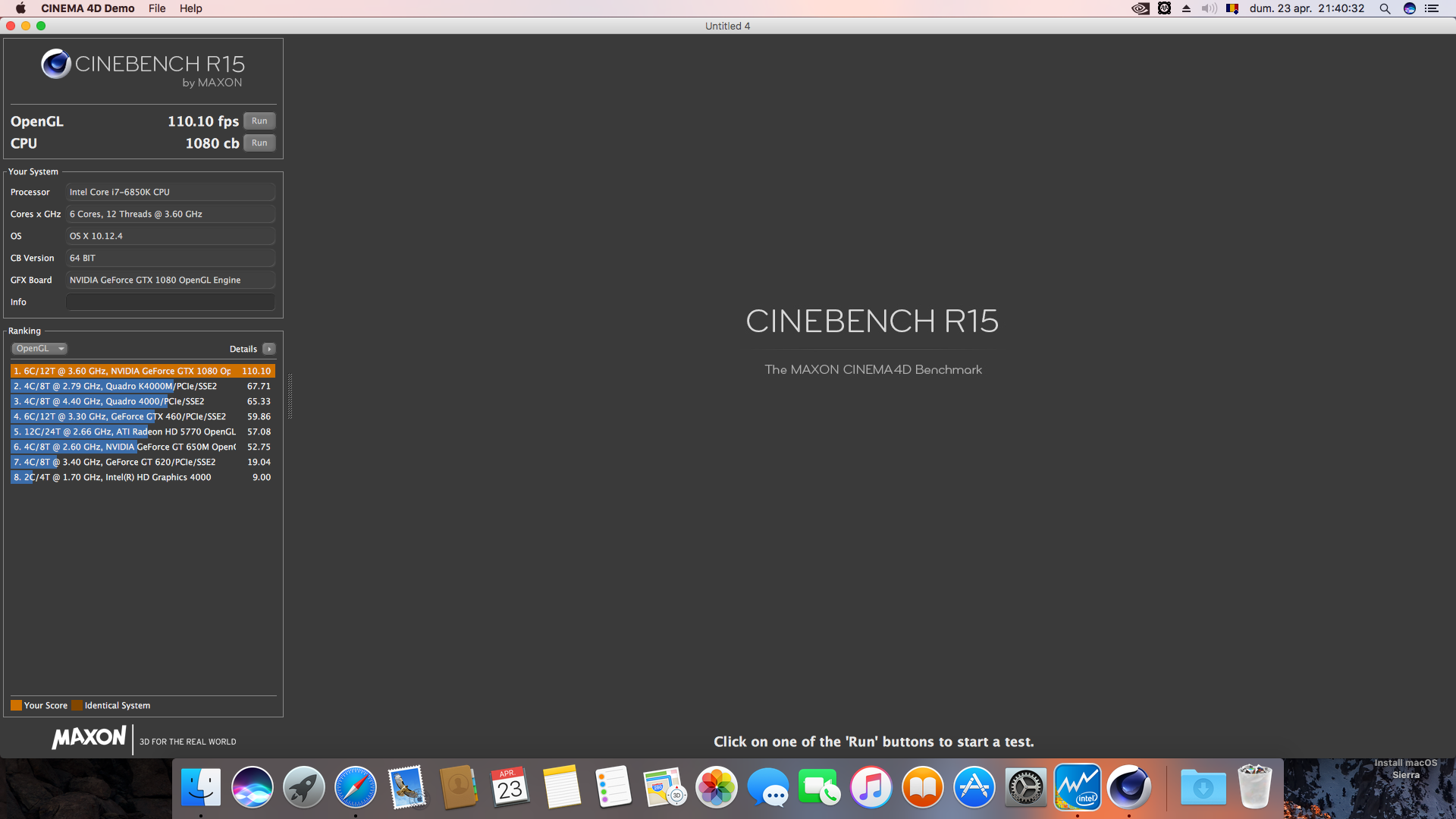

Your CPU is not working yet! Your benchmark values are relatively low.
The i7 and 4,2GHz work on Geekbench 4 with more than 24000 Points
DaTec. 4,2GHz its only in clover ..it,s cosmetic thing. My cpu run just on stock 3,6

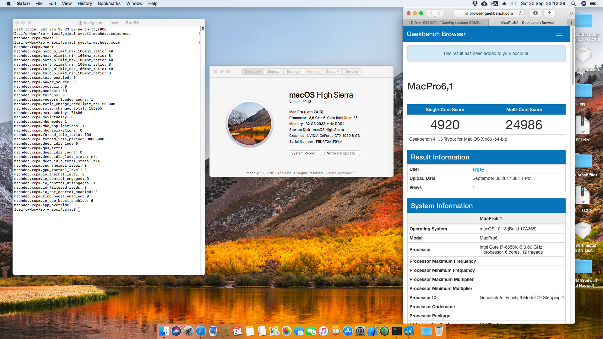

Working GTX 1080 on macOS Sierra 10.12.4

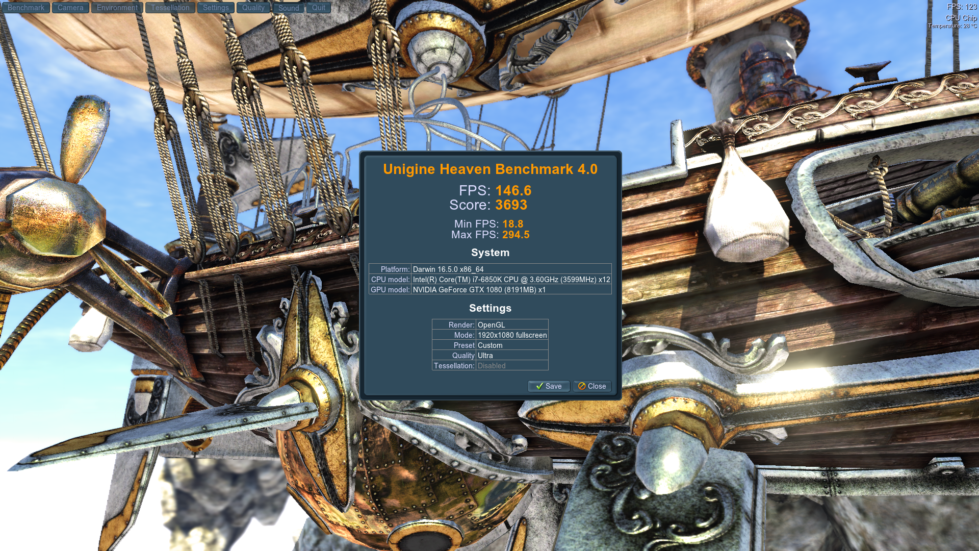

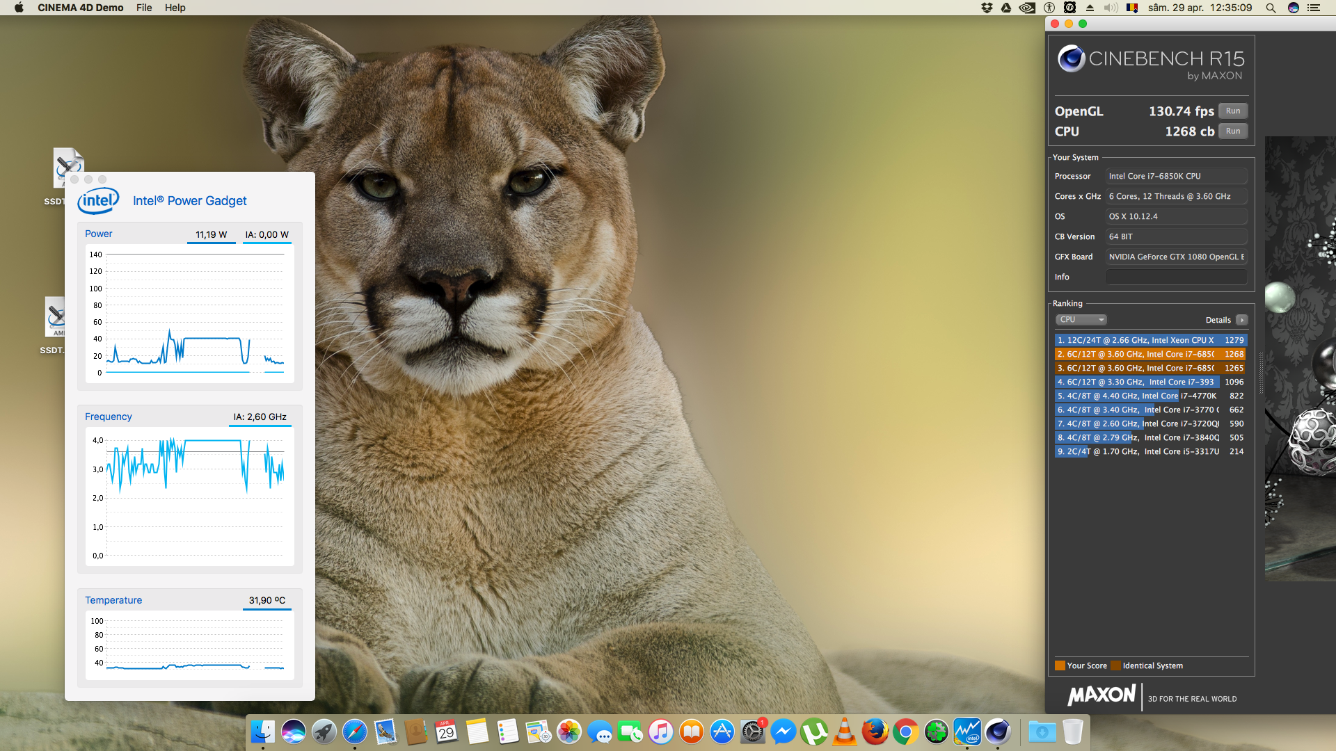

Hi man! Here are some benchmarks of X99 Ultra Gaming
First of all let's not forget to thank all those who are involved in these projects, which give us the chance to run macOS on PC. Thank you once again for everything!
1) BIOS configuration ---- a--Load Optimized Defaultsb---overclock your pc to XMP profil 1 4,2
