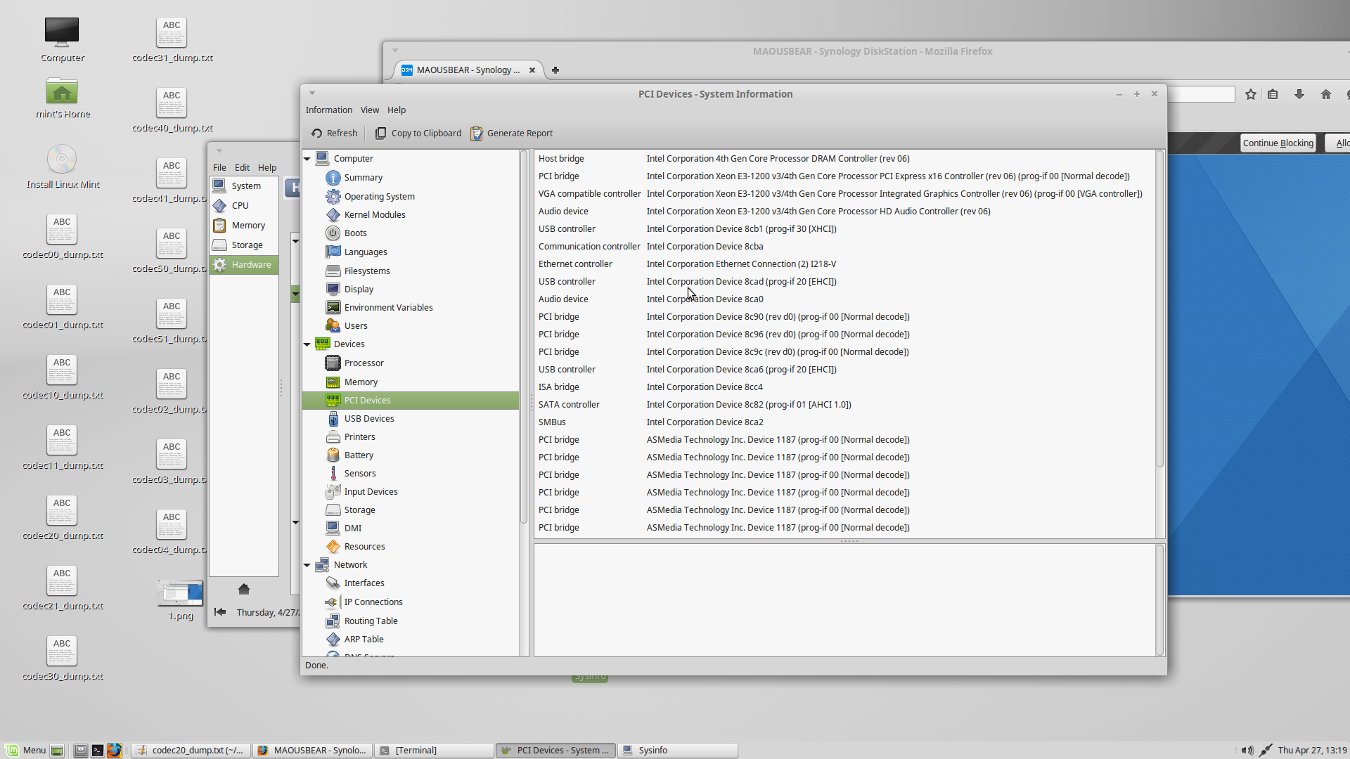

  • @Fredde2209
    @al6042
    I prepare for you guys!
    I tried to make file card0/codec#0 to card4/codec#4 in Linux mint
    and gathered more information for you!
    thank you so much!!!
    And I drop those files into the folder, and attached screenshot . (file "111.png")
    It still not work.. T_T~
  • What?? Why the heck does Asus not write that they build an ALC1150 in there?!!?!?! :thumbdown::evil: This is absolutely easy to achieve...just put those two kexts (AppleALC.kext and Lilu.kext) to EFI/Oz/Darwin/Extensions/Common and the DSDT.aml to EFI/Oz/Acpi/Load. After having restarted the system, your audio should work just fine
