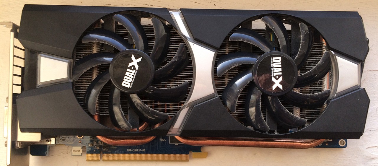

    My video card is (more certainly name): R9 280X 3G GDDR5 PCI-E DVI-I/DVI-D/HDMI/DP DUAL-X OC VERSION (UEFI)
  • Is it a sapphire card?
    Waiting for your test results...
  • I bought it as msi. Yes, it's a saphore card.
