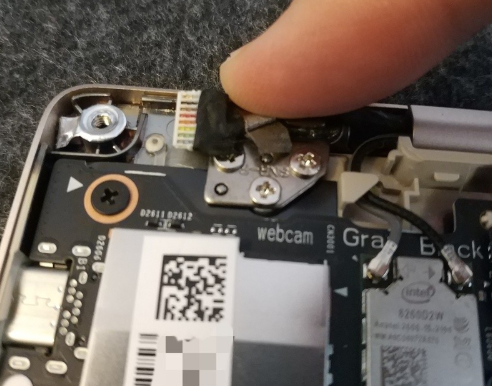

    For the Xioami 12.5 air the Webcam port seems for me the most plausible option as it is directly on the USB bus. Hence a splitter in between for the connection of the adapter would allow to keep using the webcam at the same time. Hence as I'm not a connector expert, your advice on the other ports would be more then welcome. A last resort would be soldering the pins on the USB C port (not preferable).

    @Xioami Notebook Air 13.3 & Notebook Pro users, does any one have a picture of the webcam connector or can anybody provide it?
    @OtheR laptop users with solded unsuported wIfi chipset and an open M.2 Key M PCIE slot. Please also provide a picture of your webcam connector and include the Latops brand & type

    I got an converter board, which does not seem to connect my DW1830 or being recognized. It could be the converter board itself or the DW1830 board as it is not connected to the USB bus. Yet I found a different board developed by Wdxxfu. This method is confirmed to be working as your can see in the attachment. Yet again for bluethooth we need USB bus (someone now soldered on the open slot M.2 Key B (LTE) as also shown attached.
    The option is to leave out BT or connect a splitter cable. Wdxxfu can do this for us, but we need a "PIN-OUT" of the connector. Has anyone here the knowledge to PIN-OUT a connector and has his / her hands on a Mi Notebook Air or Pro? The connector is as followed
    Pin:
    1 = Grey
    2 = Green
    3 = Yellow
    4 = Orange
    5 = Red
    6 = Brown
    7 = Black
    8 = White
    Your input is much appreciated in this matter. As soon as we have a Pinout, we have an internal WIFI with Bluetooth solution for MacOS for Notebook Air, Notebook Pro and mostlikely Mi Gaming Laptop.

  • Hi @nickl
    At this point we need to figure out which color is D+ and which color is D-. After the module should work by connecting to this interface. Wdxxfu has already the connector in stock, so only the color / pin for D+ and D- are important.
    D+ and D- needed to determined by a multimeter.
  • Maybe it is like USB so data - is white and data + is green

  • Here is the USB port.
    null、d+(d-)、d-(d+)...... up to down at this connecter.
    i add a usb wifi(RTL8188) here, work fine. but abandon webcam.
    so i want to add a usb-hub, but broke the PCB pads, very very bad luck :D
    so i find the second usb, it work, but usb type-c(the power plug) need always plug in!
    finally, i used here add the usb hub.....remove inductance and lead wire.

    Option 1, you couldnt use both the webcam and the wifi module?
    Could you provide a picture of your results on option 3 ?
