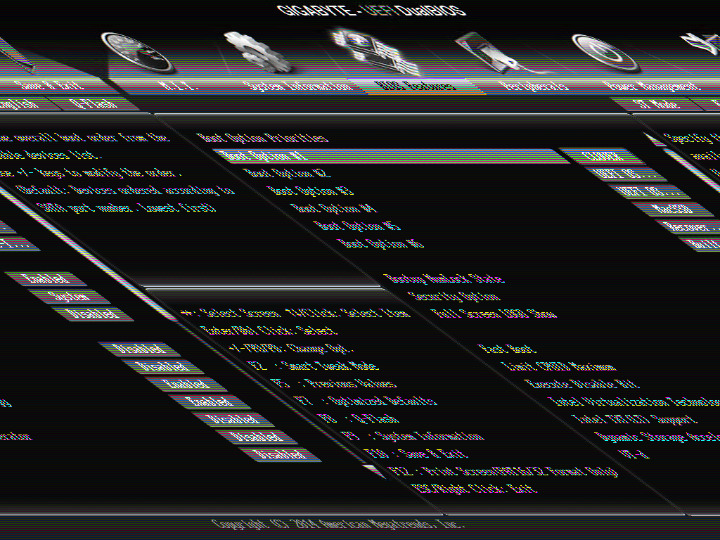

    From what i did:
    1) rechecked bios setting, toggled on CSM mode On. Here are screens on what my bios setting are now:
    2) I cant make it work because even after NVRAM flush I have blinking color screens, reboot, and freeze. Shell is not booting, nothing related to OZ not working.
    Here is the video of how it looks:
    https://drive.google.com/file/d/1DXOqrx_Jmf4abYYbtsUF1aB5U8MZA-IV/view?usp=drive_web

    I was able to watch the Video now and I absolutely have no real clue but a good guess why this is happening. I made an other version of the unsolid flavoured rom where I left out some unnecessary stuff also I tweaked the defaults to exclude any kind of Intel Injection (please make sure your IGPU is disabled in Bios as well do not only set the NVIDIA to primary display but also completely disable your iGPU since the P4600 will not work at all). Please also delete any defaults.plist you may have on /EFI/OZ to make sure my modifications get loaded (I enabled verbose Mode by default to see what's going on). Please give it a try and report how it's going.

    I was able to watch the Video now and I absolutely have no real clue but a good guess why this is happening. I made another version of the unsolid flavoured rom where I left out some unnecessary stuff also I tweaked the defaults to exclude any kind of Intel Injection (please make sure your IGPU is disabled in Bios as well do not only set the NVIDIA to primary display but also completely disable your iGPU since the P4600 will not work at all). Please also delete any defaults.plist you may have on /EFI/OZ to make sure my modifications get loaded (I enabled verbose Mode by default to see what's going on). Please give it a try and report how it's going.
    With this ROM I cant enter bios settings, only f12 or "end" menu works. When I try to enter bios settings, I've got an only flickering monitor like it's searching for video connection and that's all. Nvram working as on video, after boot nothing happens or freezing.
  • After flash and before anything else press ESC Key several times to disable OZ (Screen turns red) after the screen turned red enter bios (hit del directly after the screen turned red) and adjust your settings (disable IGPU, Set Primary Screen to NVIDIA, Select "other os" and so on) and save them. Restart and let OZ do it's thing.
