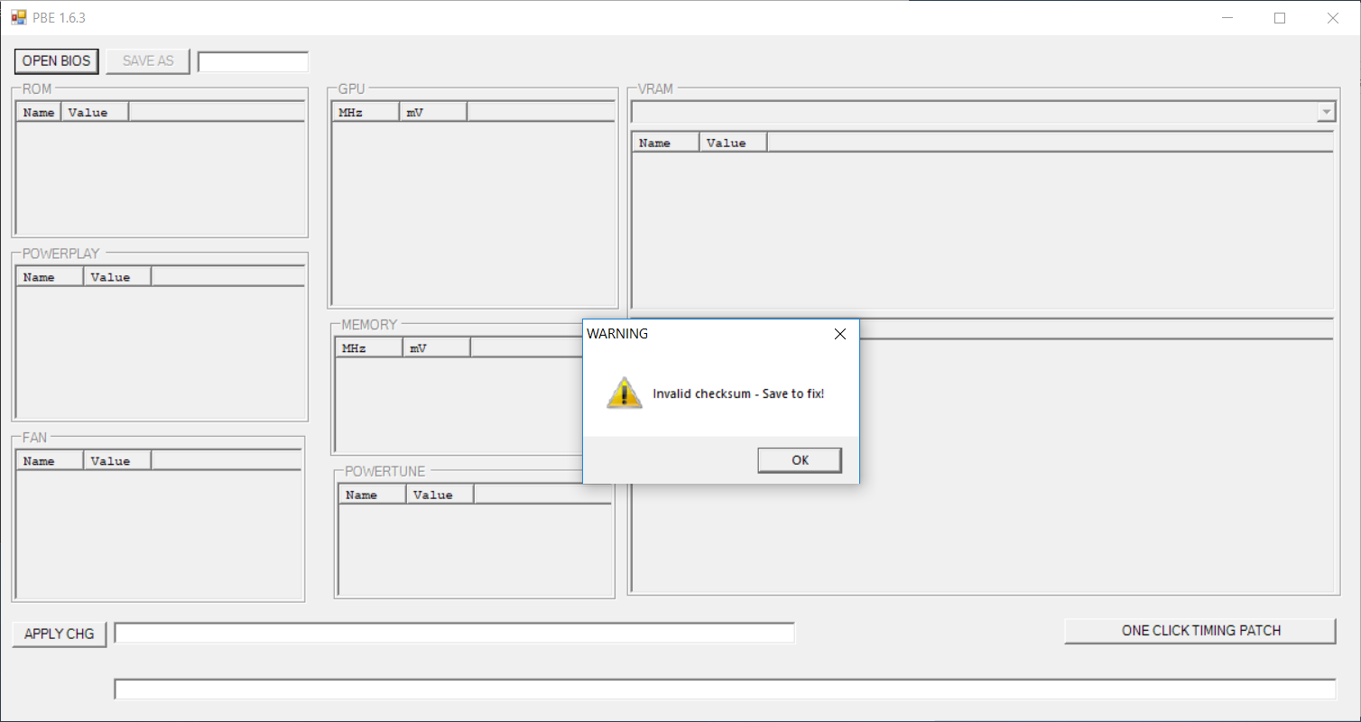

    5. The new ROM will have an invalid checksum, so you won’t be able to flash yo card with ATIWinFlash yet.
    To cope with that open yo ROM in PolarisBIOSEditor. It will tell U 2 save the VBIOS in order to fix this error.
    6. Now simply save yo ROM as... I saved as "bios".

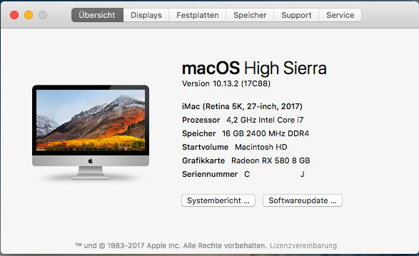

    This is the result of my job.
    My Sapphire Radeon RX 580 8GB NItro+ do not need anything (WeG, RDI, FB) until macOS High Sierra 10.13.5
