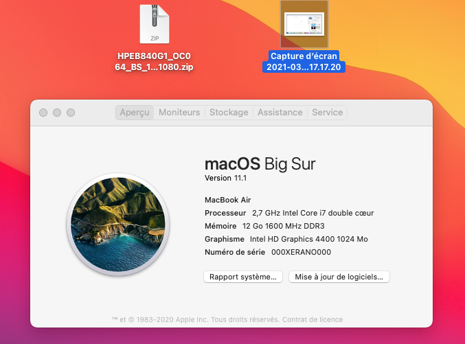

  • Hi all,
    I'm on a HP 840G1 (i7 + 16 GB) with Catalina and everything is working perfectly (Intel Wifi, Bluetooth, messaging..). I'm now trying to use a docking (HP UltraSlim Dock 2014) with 2 monitors:
    - USB is working fine for Mouse and Keyboard.
    - the PowerOn button is not working
    - 2 screens are not detected.
    - I don't know if sound (output and input) is working yet.
    Would you share your experience / or EFI ?
    Thanks.
