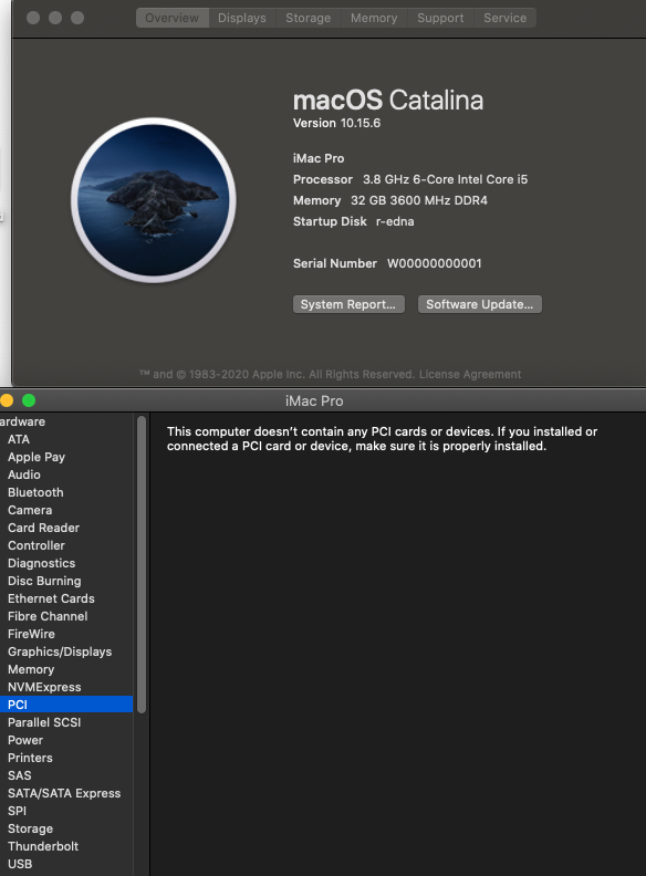

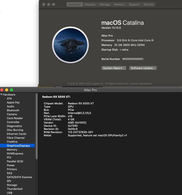

    OK, so I went back to my "original" config.plist (the one that works well with my Rx590) and started again to edit it in order to use the Rx5500XT.
    This time I did everything I could in ProperTree (adding the boot-arg, adding the patch into Kernel->Patch) and then I used OpenCore Configurator to add the part in DeviceProperties (including the ATY,Rom# injection). Again, I did all that while the Rx590 was in the PC and The values OpenCore Configurator added for PciRoot..., AAPL,slot-name may be incorrect. Once again, for ATY,Rom# I just copied the value I found here.
    After Saving and exit OpenCore Configurator, I tried opening the file with ProperTree and This time I didn't get any error message from ProperTree and the file opened normally (this was a small win for me :D )
    I shut down the PC and replaced the Rx590 with the Rx5500XT, booted, and this time I didn't get any error message early. So I guess the patch found the data it was supposed to replace, maybe... I don't know... I reached the Apple logo and this time the progress bar went to about 75% before I ended up with a black screen (damn!)
    However, I can reach macOS via VNC. The display is low res (as if the GPU wasn't recognized), but SystemReport seems to show my Rx 5500XT

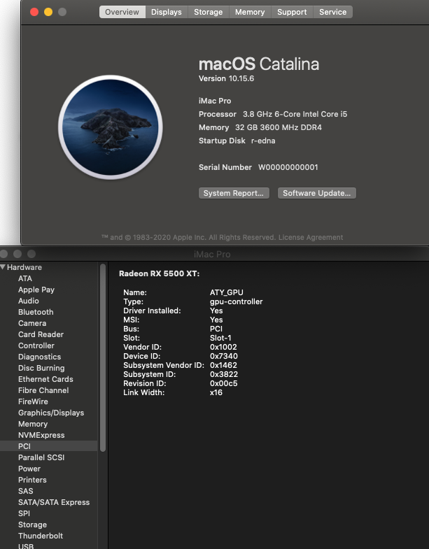

  • Then I don't know. I dismantled my rig recently to upgrade so I cannot check what value my old RX 5500 XT had...
    It does not work without the ATY,Rom property injected? The bug is described within the installer, so it should run without any injected properties/ACPI renames as far as I understand the issue.
  • I did all that while (…) AAPL,slot-name may be incorrect.
    "WhateverGreen.kext" should provide any correct values. Only the specification of the "PCI slot" _COULD_ look a bit strange due to the ACPI (not optimized for macOS).
    If you want to change that, the entry "AAPL, slot-name" is sufficient. For this I would use the value "Slot-1" instead of "Internal ...", because the graphics card is in a PCIe slot and is not integrated on the mainboard.
    Thanks :)
    I removed ATY,Rom# and indeed nothing changed.
    Not better, not worse
    In the beginning, I also thought that I shouldn't add anything in DeviceProperties (only the boot-arg and the kernel->patch, as described in the installer guide on Dortania). However this didn't work either. Maybe now I should revert and see how different it was compared to where I am now...
    Thanks :)
    Should I replace "internal@0,3,1/0,0" with "slot-1" or rather "slot-1@(something)"?

  • 1. Please try what I added in # 16.
    2. Maybe remove "agdpmod = pikera"
    (NVRAM \ Add \ 7C436110-AB2A-4BBB-A880-FE41995C9F82 \ boot-args)
