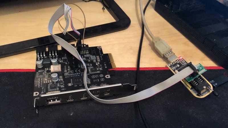

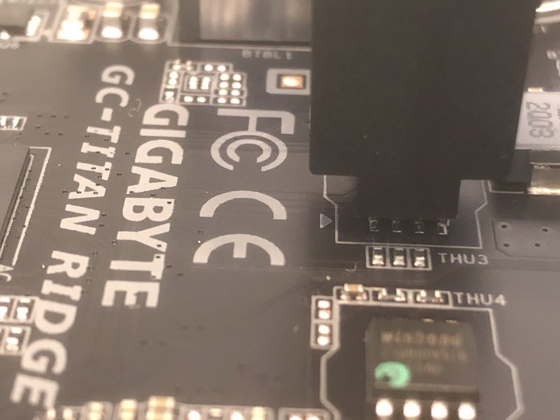

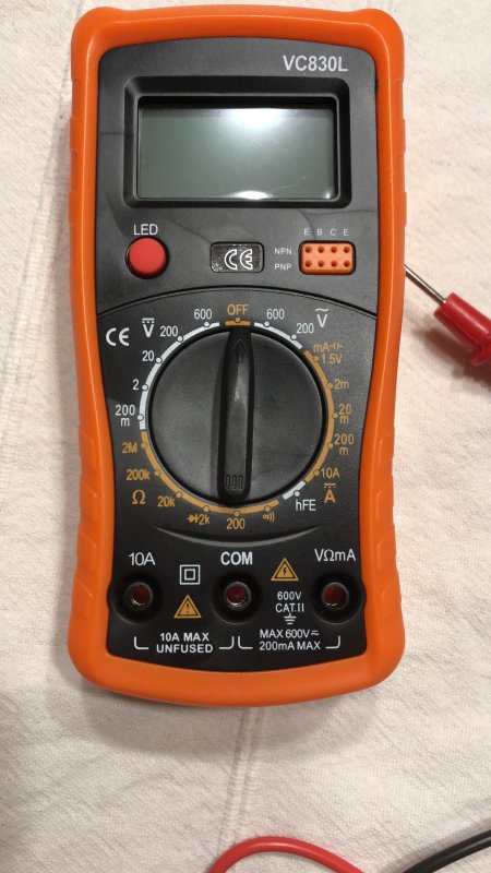

    Flynn_LG I have flashed my Titan Ridge 1.0 by myself with that object you posted ( I am not expert at all with this stuff and I was very lucky) :)
    before I have misured with a multimeter volt to be sure
    Thanks for your post about the Titan Ridge! Your pictures are quite interesting, because I didn’t think that you modified your flashing device to output 3,3V (you checked it with the multimeter but didn’t modified anything). Am I right or did you do it?
    kaneske  Raptortosh Vom Löten habe ich schon Ahnung, ist natürlich alles relativ klein, aber wenn’s wirklich nur diese beiden Kabel sind, geht es locker klar.
    Mit freundlichen Grüßen,
    Flynn_LG.
  • Thanks for your post about the Titan Ridge! Your pictures are quite interesting, because I didn’t think that you modified your flashing device to output 3,3V (you checked it with the multimeter but didn’t modified anything). Am I right or did you do it?
    Yes there is a piece you can see in my photo I have mounted, then I have checked their voltage..it was 3.3....flashed without any problem and .. I am not able to build a bridge on the flasher chip as I see someone must do to achieve correct voltage
    I was lucky because if my multimeter had shown 5 v..I would have to stop my try because I wouldn't be able to solder that wire! :) :)
  • fabiosun I understand, but still a little bit weird! Very very Lucky for you! Maybe I also have that luck and didn’t have to solder it. If not, it’s not that big deal for me. I will see if the flashing device is ordered and arrived.
    Flynn_LG.
  • Nur um es ganz deutlich klar zu stellen. Da liegen 5V am Chip an, egal was ihr tut. 5V ohne Mod. Es ist so, egal welchen CH341 ihr nehmt es bleiben ohne Mod:
    5…FÜNF…FIVE Volt.
    Richtiges Messen liebe Freunde. Es sind grmpf 5V und das kann den Chip grillen. Der Mod ist leicht, schnell gemacht und sorgt für 3.3V an allen relevanten Stellen gegen einander und Masse.
    Glaubt mir das bitte ich hab davon mehrere gehabt und alle hatten diese 5V an den PINs.
    Schnell mal nicht gemacht und schwups ist die neue Karte im Eimer.
    Kann auch gut gehen, aber ohne Mod ist es Risiko.
    Read carefully:
    https://wej.k.vu/electronics/ch341a-mini-programmer-fix/
  • kaneske Okay verstanden:pinch: Ich hätte mir gut vorstellen können, dass der Hersteller des Tools was anders gemacht hat. Aber gut, dann werde ich die Mod vornehmen!
    Flynn_LG.

    kaneske kurze Frage nochmal an dich, da Amazon mir eine 2.0 Titan Ridge geschickt hat und keine 1.0. Was genau spricht gegen eine rev 2.0 bzw. warum sollte ich lieber die rev 1.0 verwenden? Sonst schick ich sie nämlich zurück.
    Vielen Dank im Voraus :)
    Flynn_LG.
  • Bei der 2.0 musst du halt die richtige FW nehmen. Solle und wird aber auch gehen.
    NVM50 CaseySJ wird es dann bei dir werden, es sei denn der Urheber hat was einzuwenden :-D  NERD
    https://github.com/utopia-team/Thunderbolt
    Ganz nette Anleitung:
    https://github.com/ameyrupji/t…b/master/GC-TitanRidge.md
    Bei der Anleitung brauchst du aber nur den Flash Teil und ggf die Brücke, die aber auch nur wenn dein Board keinen Header hat, sonst schließ das so an wie gedacht, also das 5-Polige Kabel von der Titan Ridge 2.0 an das Mainboard. Das soll so und kann auch so.
    Die PCIe Spannungsversorgung brauchst du nur für PD, also Laden an den Ports, also meist kaum. Daher kann das auch unabgeschlossen bleiben.
    Das USB Kabel dient USB 2.0, kannst du anschließen, Portmapping aber nicht vergessen.
    Danke für die Aufklärung! Anscheinend hat der Urheber nichts einzuwenden, wodurch ich die rev 2.0 einfach behalten werde und es dann mit der FW auf GitHub versuchen werde;)
    Das Board hat einen Header. Bridge kann also auch weg gelassen werden.
    Flynn_LG.
