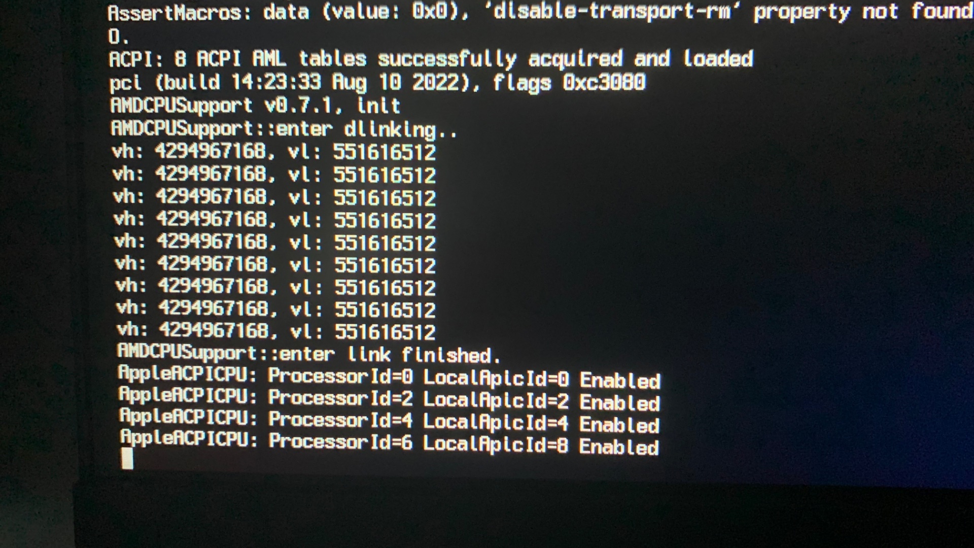

  • Ninjiopl we have tried many "working" EFI for system pretty similar to yours
    every time an EFI does not start it is useful to see where it hangs
    Are you sure that your motherboard bios is well configured?
  • So i go to the BIOS and your right "Above 4G Decoding" was Disabled, so I Enable it, but the other settings were alright
    use above efi you posted and take a photo where it hangs
