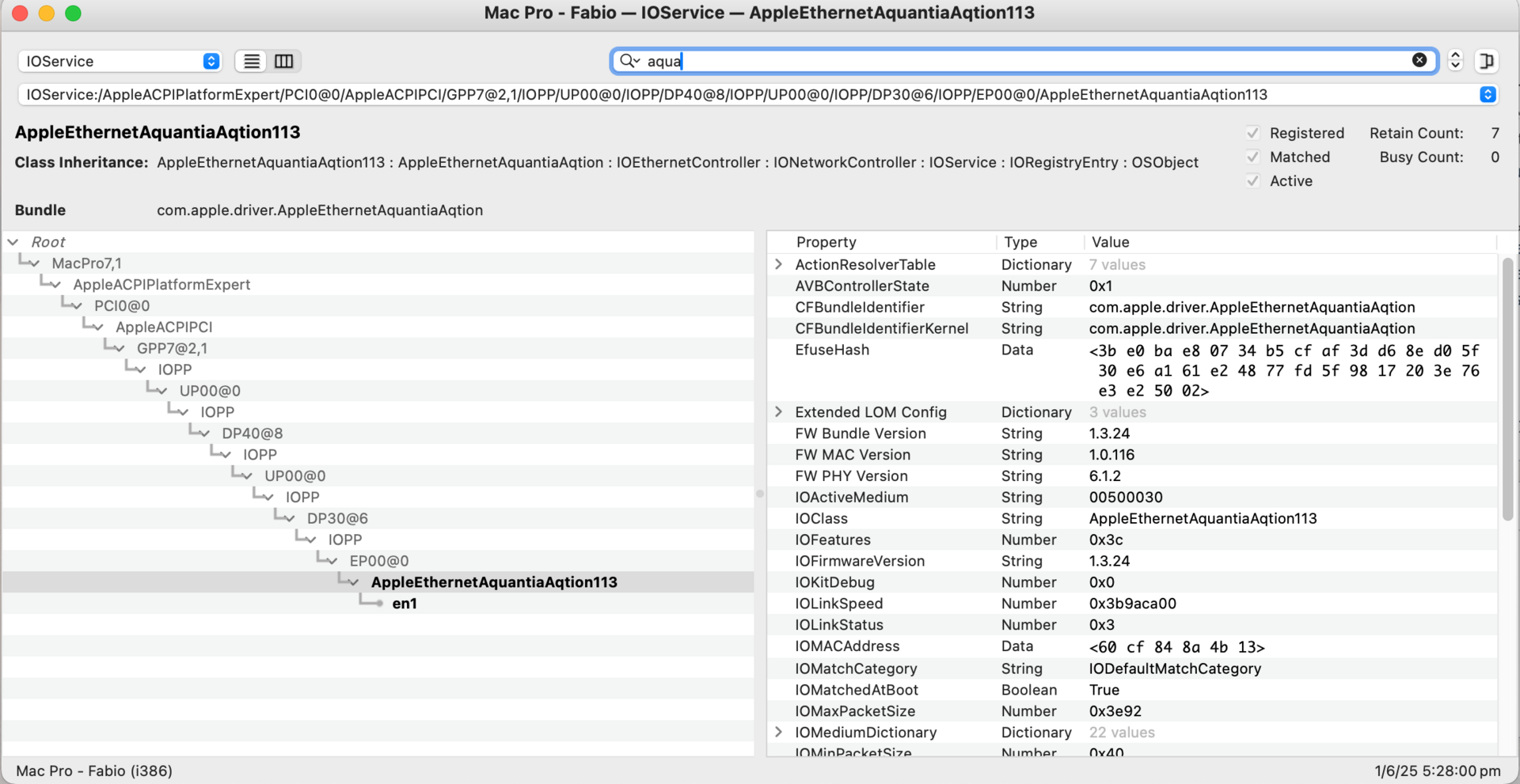

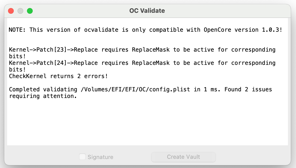

  • I have seen this post and I tried to install the patches but I couldn't load them. Tried with the newest versions of OCAT and OC Configurator but no success.
    this is your config with two kernel patches i use for my aquantia
    if you like you can try
    Bt the way..OCAT has some errors with these patches but they are working fine

  • UPDATE
    fabiosun I have some very good news :)
    Both of my network adapters are working with the patches that you included in my config.plist. What a joy!
    I had to disable VT-d in the BIOS and after a NVRAM reset and a reboot, both cards work perfectly. Thank you soo much for your help.
    Of course I have to do some more tests but so far, everything looks fine.
